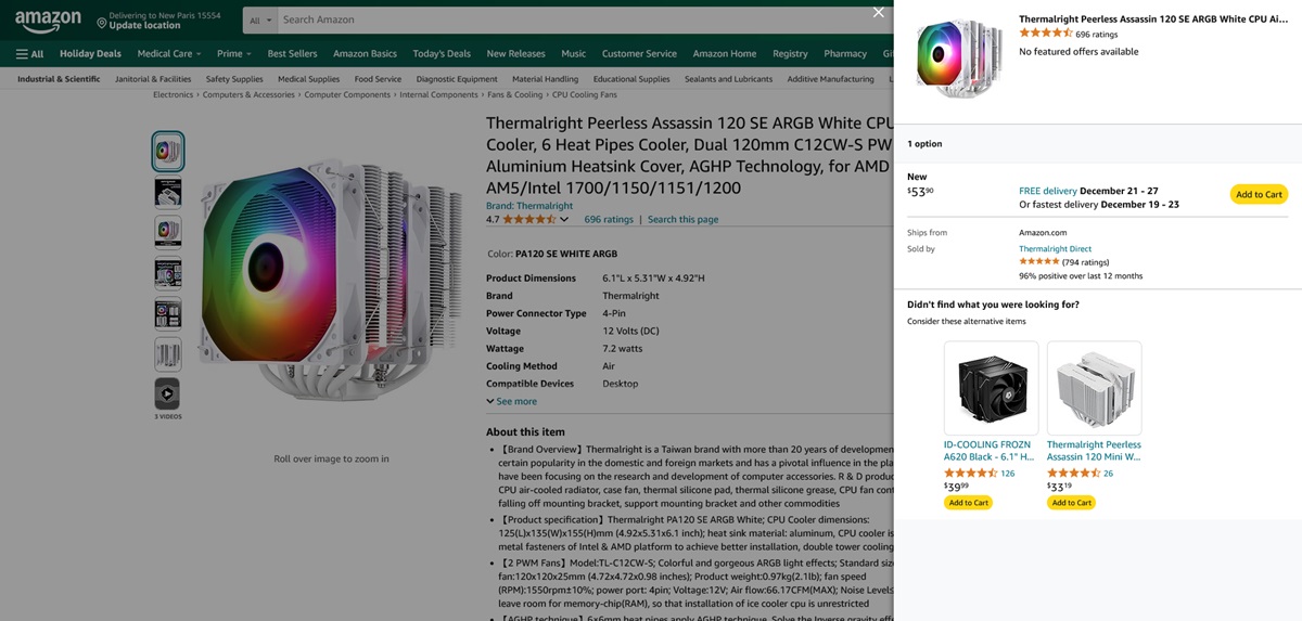

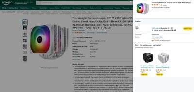

This is the one that I got. Absolutely love it. It has no problem fitting in my case. It actually cools better than the Corsair H100i AIO that burnt up. Its cooling my AMD Ryzen 7 5800X very very well. Current CPU temp is 36c while watching a movie on youtube but it is a little chilly upstairs. around 64F 17.7c. I bought it in July of this year and it never got above 68c on a 100F+ day.
Here is the one that I bought. The White ARGB one was on sale for $43 when I got mine. It's currently $54.90.
